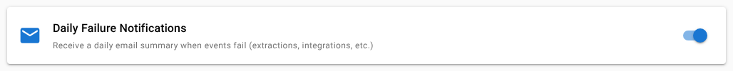

  1. Click Event Logs in the sidebar.
  2. Find the Daily Failure Notifications card, below the statistics.
  3. Click the switch. The change is saved straight away.
The Daily Failure Notifications card on the Event Logs screen, with its switch turned on
To stop the emails, turn the same switch off. The email goes to your account's email address; see Profile, password and two-factor to change it.
